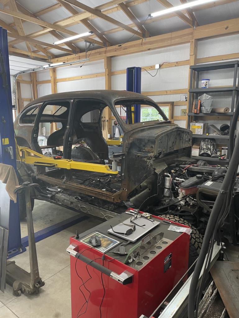

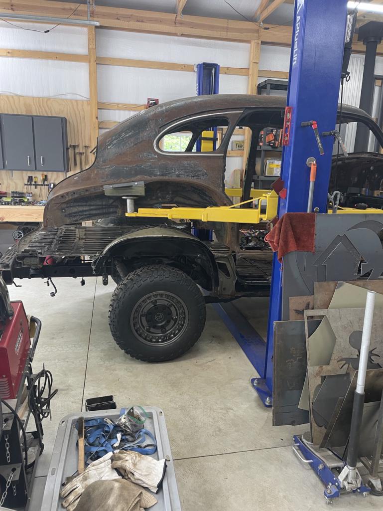

East coaster   I’ve got the body on the chassis and it’s work...   Jun 17 2025, 08:49 AM
