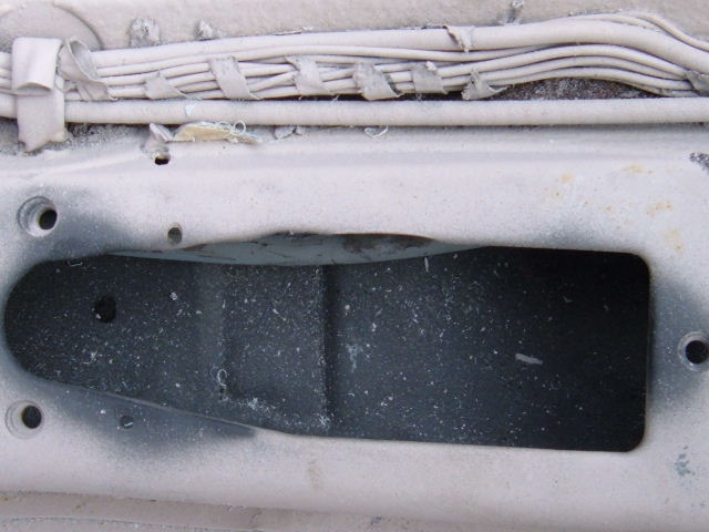

Here is what I got so far----see how the tube is to the far right of the tunnel--
What I need to know is--: does this tube stay to the right or left of the rear shifter mount bolt--and--is it on the floor or does the shift rod pass underneath it?? This way I have a bearing on where to properly bend it-- TIA Attached image(s)

redshift Uhh.... the toob runs down the right side, and end... Feb 5 2005, 02:12 PM
redshift AHA! It stays to the RIGHT, on the floor, and ... Feb 5 2005, 02:14 PM
redshift The twist/bend in the forward end of it is suppose... Feb 5 2005, 02:15 PM
jwalters http://www.914world.com/bbs2/html/e... Feb 5 2005, 02:19 PM
redshift Yes... try to visualize the path the cable will ex... Feb 5 2005, 02:22 PM
jwalters http://www.914world.com/bbs2/h... Feb 5 2005, 02:27 PM
redshift If you don't drink, you'll get 7.89 more m... Feb 5 2005, 02:32 PM
vsg914 Just did this to a car this week. The tube starts ... Feb 5 2005, 05:04 PM
jwalters <... Feb 5 2005, 05:07 PM
