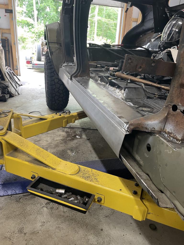

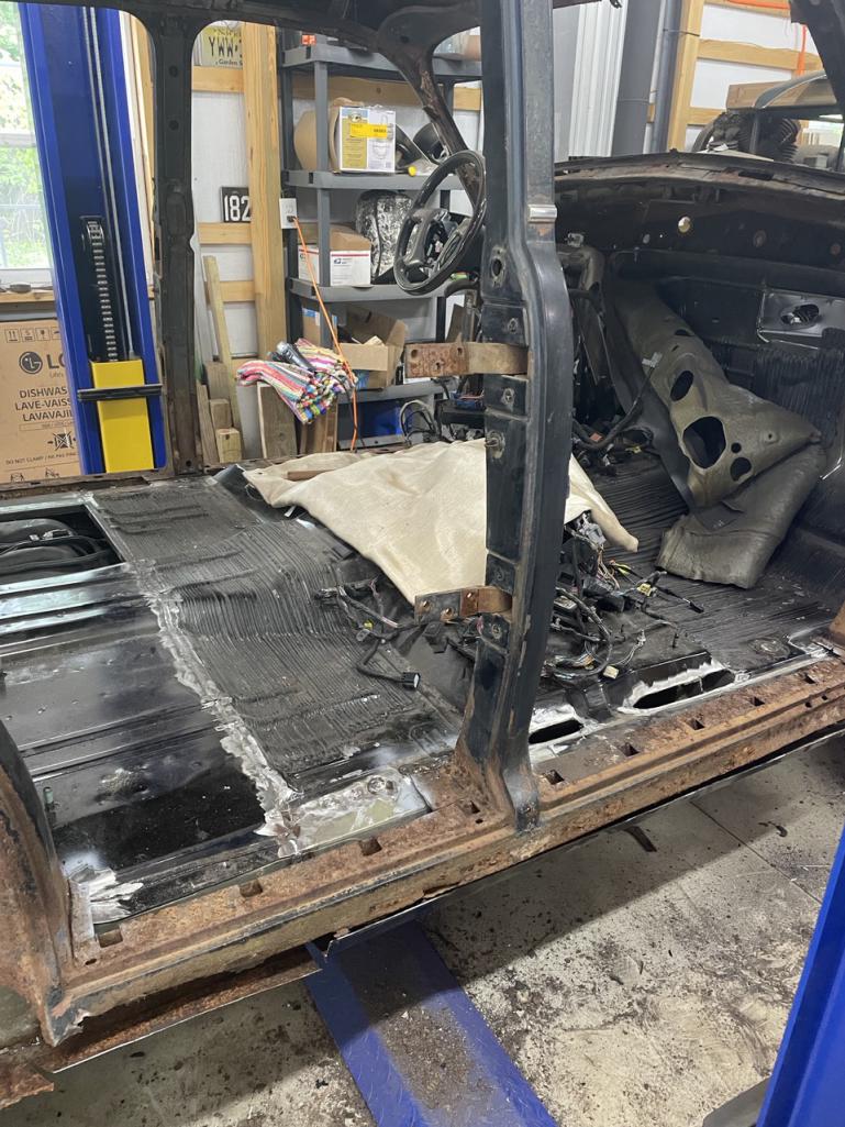

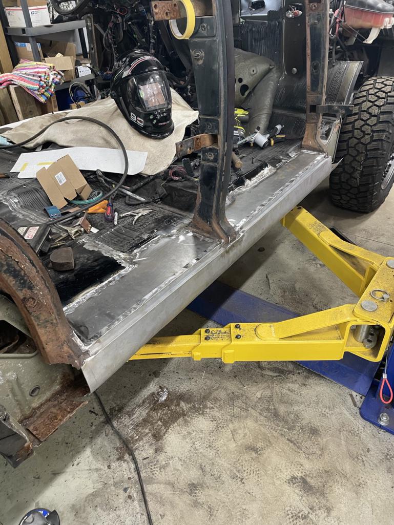

I’ve got the body on the chassis and it’s working out well so far. I welded the floor pan back together and started welding the body to the floor pan. Yesterday I made new sill plates to tie the 41 body to 08 floor pan, and made new rocker boxes…..it’s coming along.

East coaster   Made the sill plates and rocker panel on the drive...   Aug 14 2025, 05:02 AM
