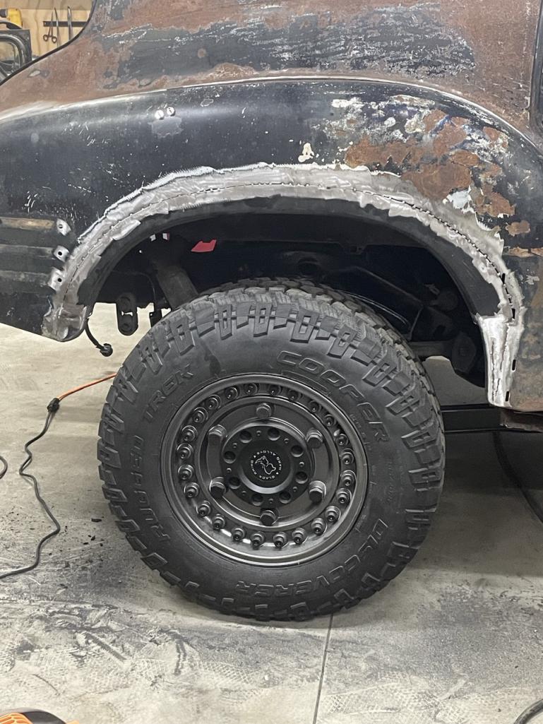

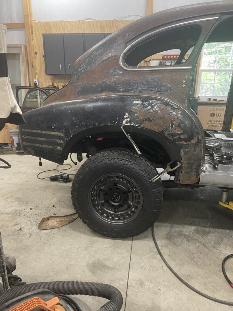

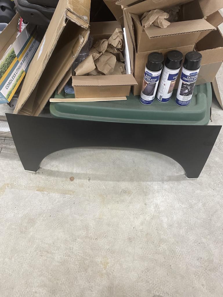

Made some rear fender mods. I had to make the opening larger and move it back a couple inches. I got fender repair panels for a 2004 Dodge pickup and used the lip to create the arch I wanted, then re-blended the lower fender from the Caddy. I need to finish weld them but think they’re going to look good.
