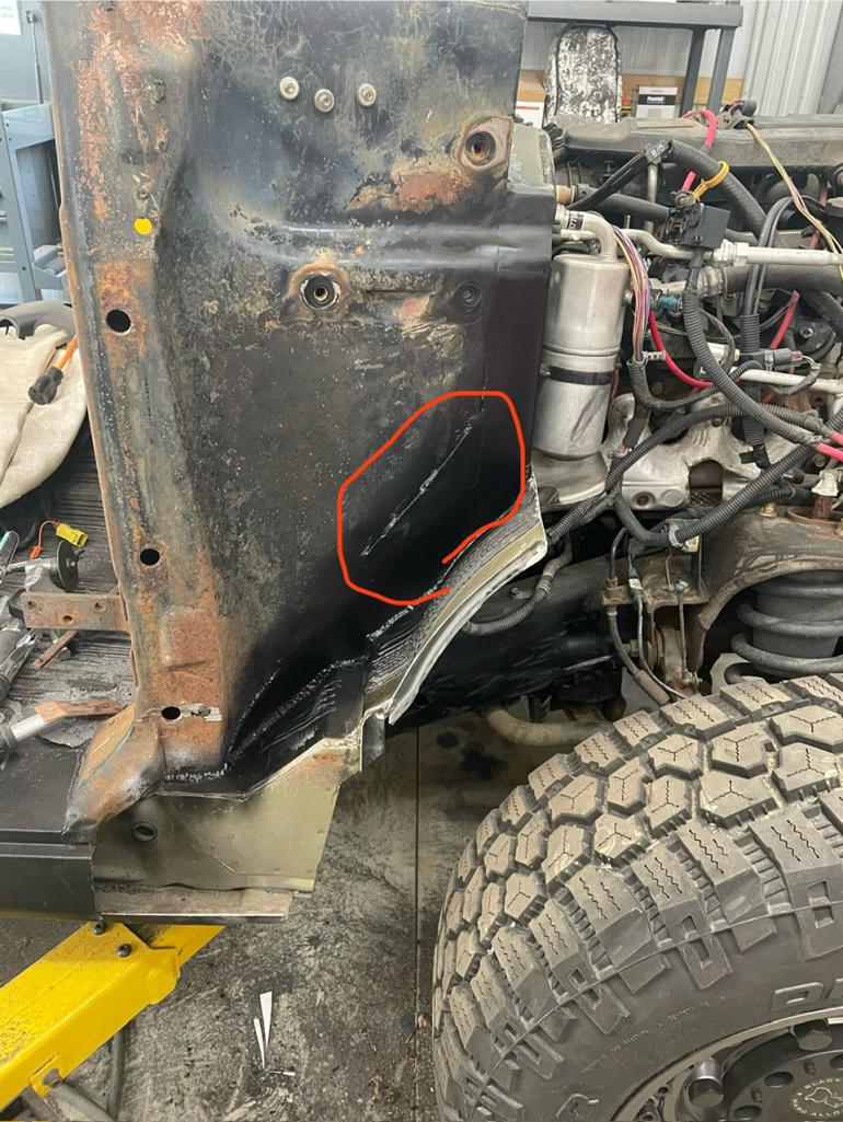

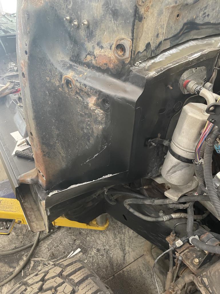

Moved on to the front fender well and firewall area.
Here’s tying the caddy body to the Yukon floor pan at the front wheel well. The ugly seam and welds (circled in red) is factory Cadillac workmanship (IMG:style_emoticons/default/smile.gif)
