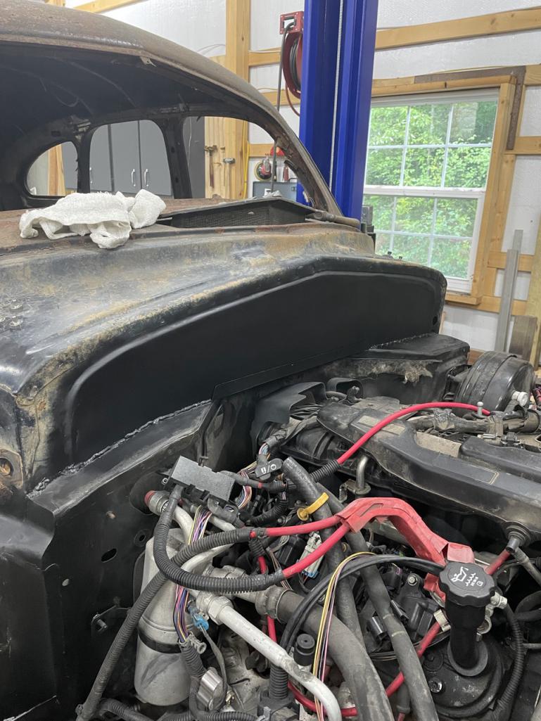

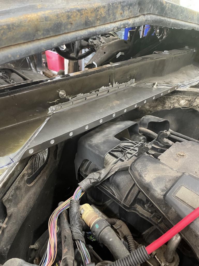

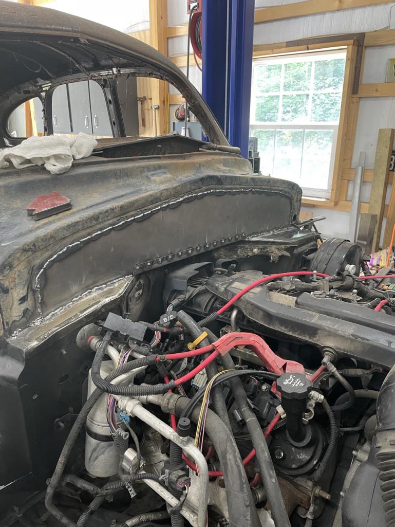

Next was the firewall. I had to make a small triangular part to transition from the shape of the Yukon firewall to the Caddy shape (flat).
