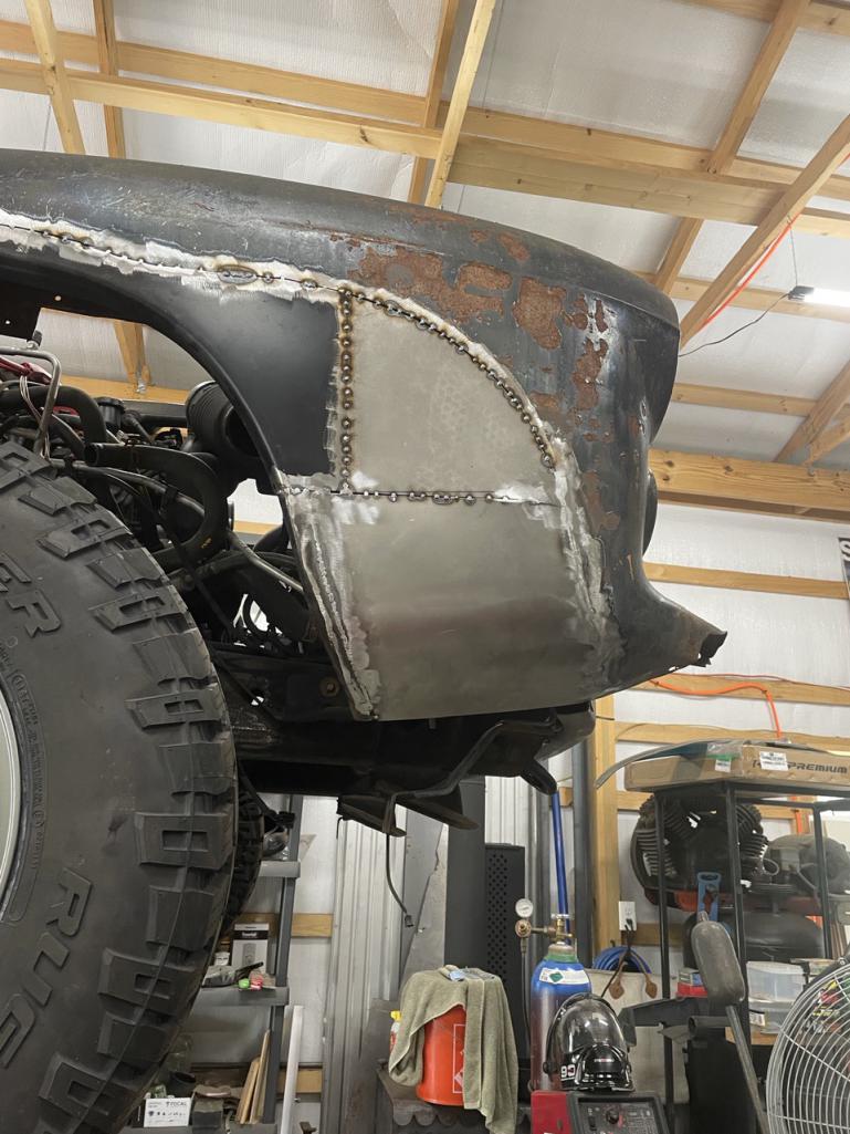

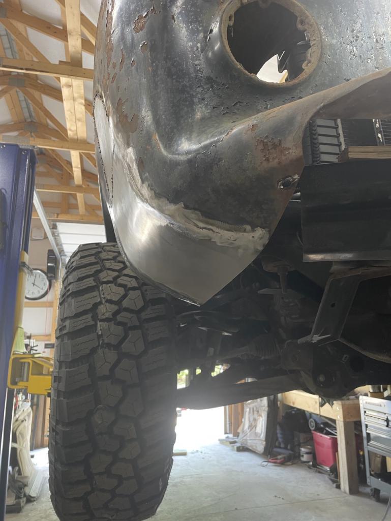

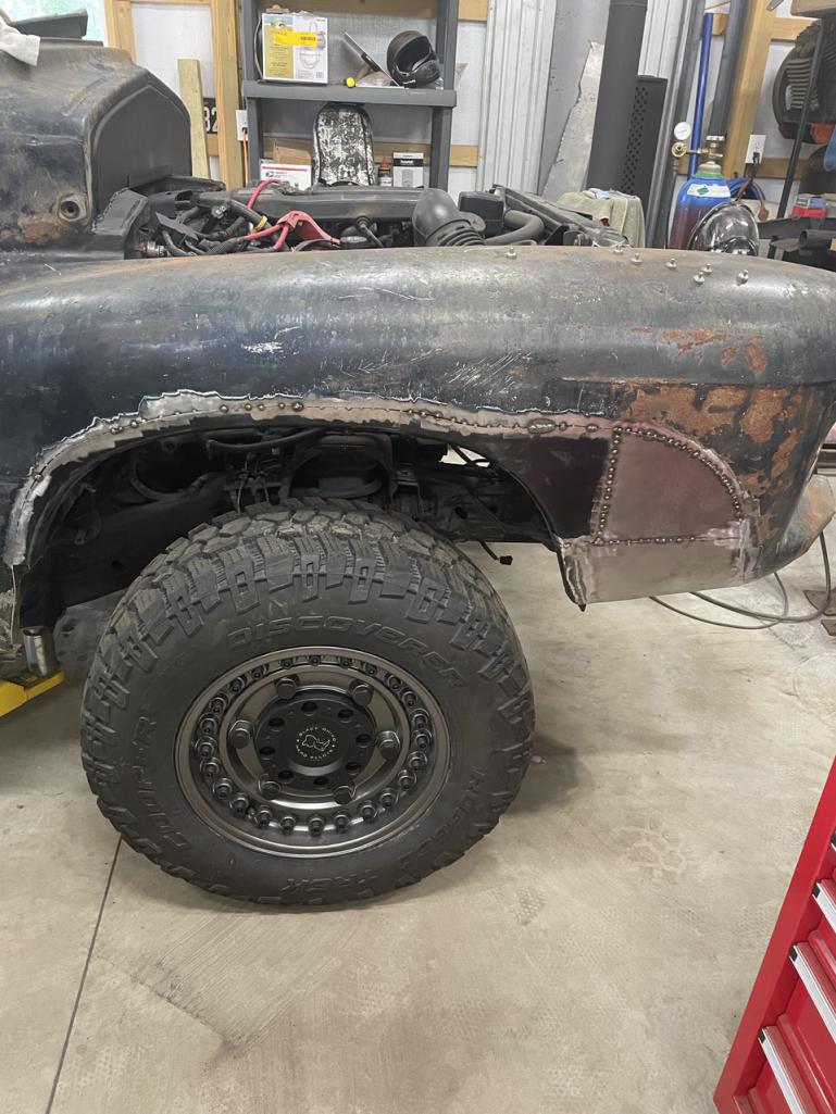

Decided to attack the front fender next. I had to relocate the fender opening 11.5” rearward and was really worried how this would look. I used the same fender lip as the rear fender (dodge pickup repair panel) but had to fab the area in front of the opening to blend with the curvature of the fender. I’m happy with the results and it looks pretty good. Minimal filler and it will look like it was made this way.
