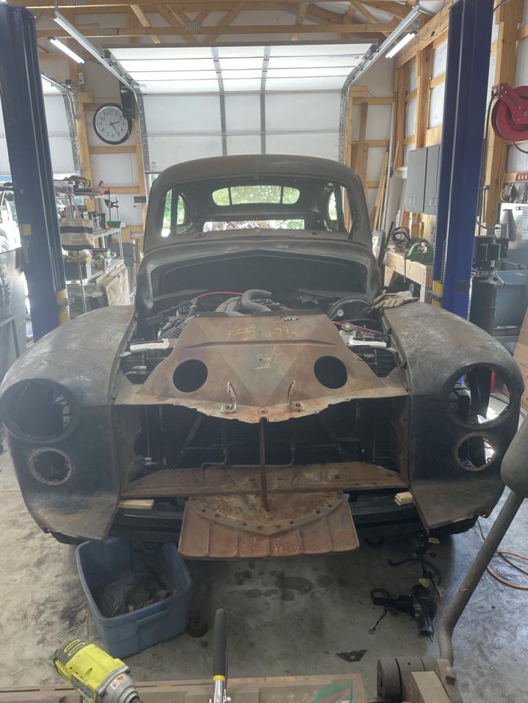

Been busy on the project even though it’s been dismally hot….feels like temps of 120 and I’m sure I’m boosting that a little by welding all day…ugh!
That said, I’ve made good progress. I wasn’t sure if I would be able to retain the stock GMC radiator and fit it under the hood line. There was no single mod to lower it down, but I found 8 different little mods that collectively allowed me to move it down to clear…yay!
Next was fitting the Caddy radiator support and making sure I could modify it to fit. I’ll have to fabricate a new top section but that’s not a problem.

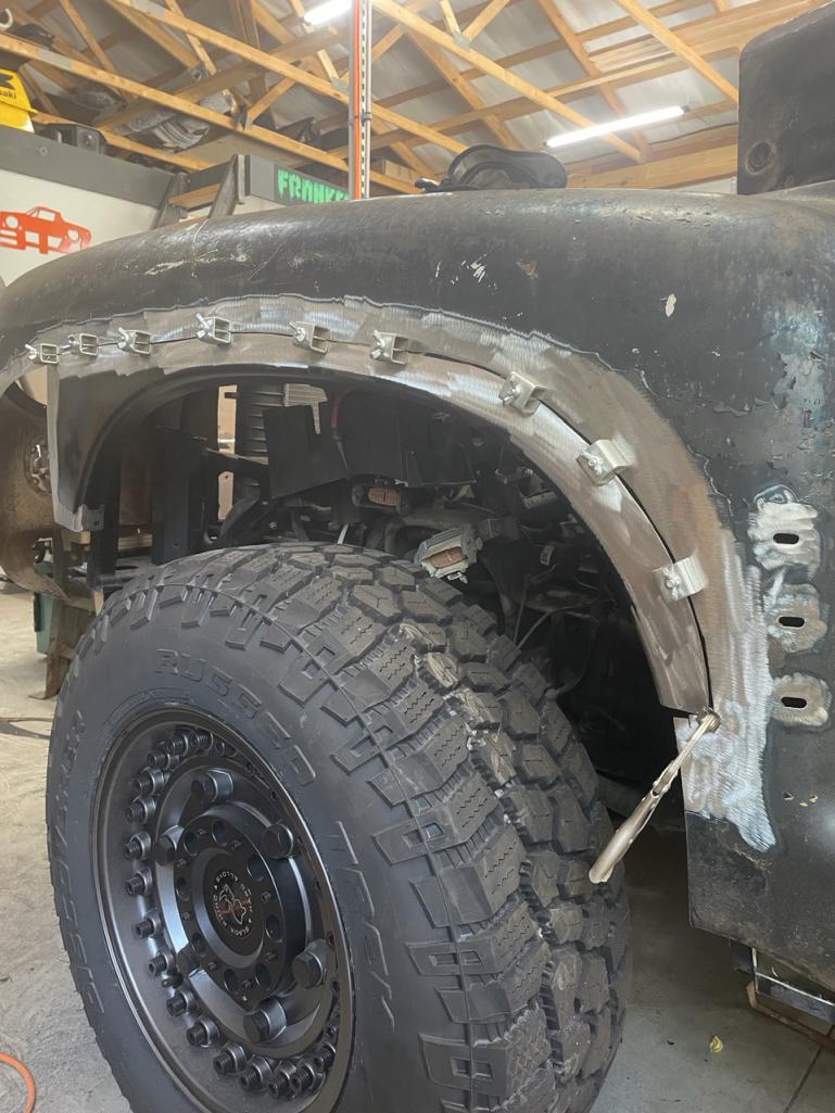

Also finished modifying the other front fender to move the wheel arch back and enlarge it……getting there!
