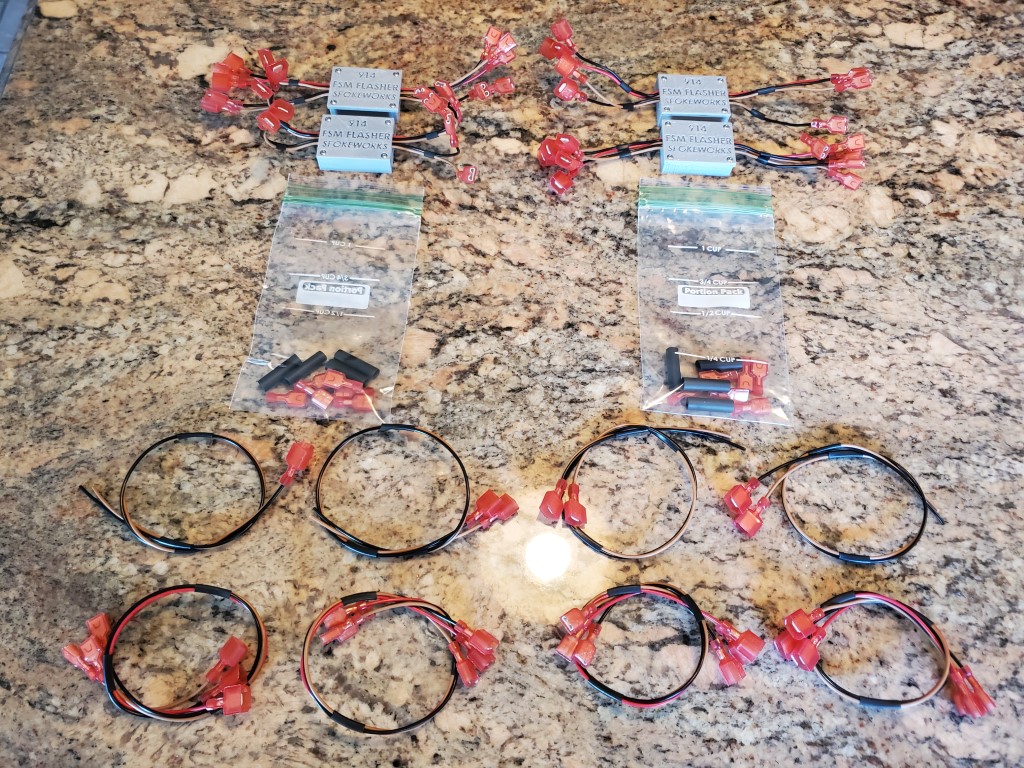

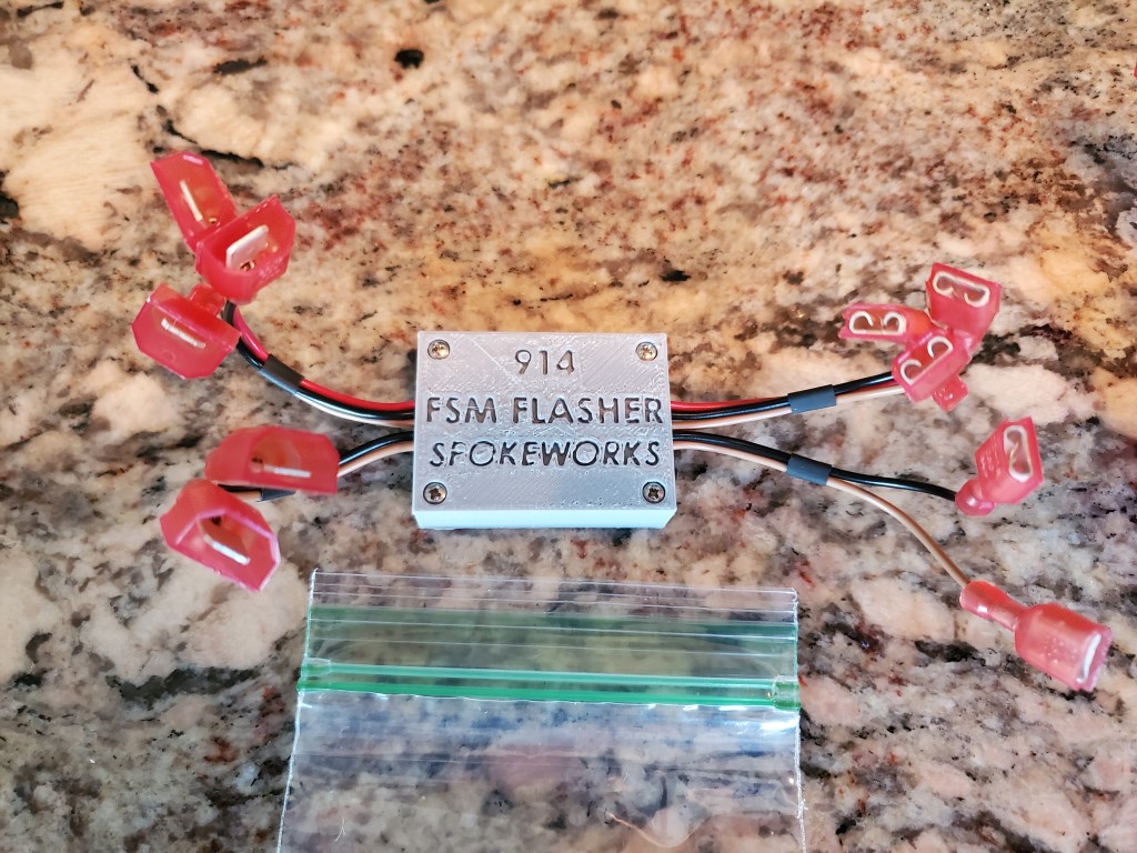

Your front sidemarker flasher assemblies are ready to ship.
Included:
2 FSM Flasher modules
2 FTS harnesses
2 FSM harnesses

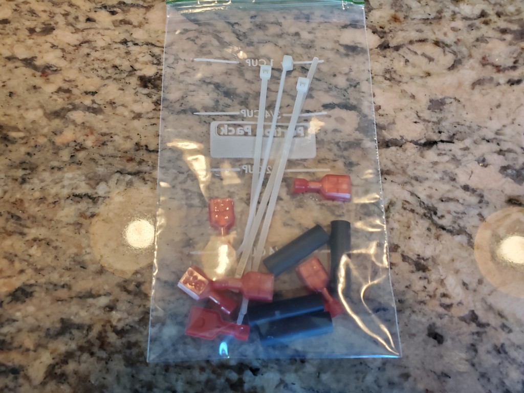

6 Female QC connectors for the FSM harnesses
4 1/4in Heat Shrink tubes
4 Tie wraps
Thanks for trying these out. No charge for these though I'd appreciate feedback on the install and operation. Please take a couple of pictures if possible and post them and feedback on this thread.
The instructions aren't on my website yet so I'll list some things here.
The module and harness connectors are polarized so it should be easy to get input/output correct.
The I/O wires on the modules are grouped for the turnsignal (3 wires) and sidemarker (2 wires)
The female connectors on the sidemarker harnesses are to be installed by you after fishing through the rubber boots.
The input side has male spades to connect to the OEM wires and the output side has female spades to the wire harnesses.
QC connectors for the sidemarker harnesses and a few extra. Heat shrink tubes are for any OEM connectors should they not have insulation. Tie wraps to clean up the wiring.
