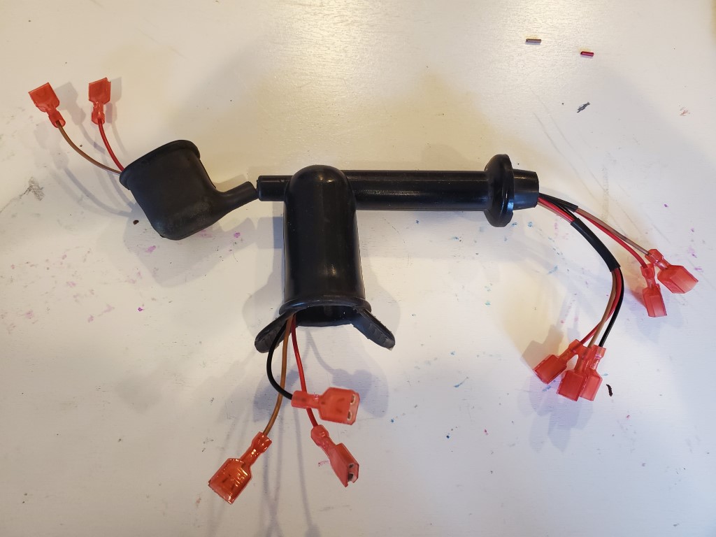

The installation procedure is:
1) Jack the car up and remove the front tire for the best access.
2) Pull back the boots from the turnsignal and sidemarker and pull all connectors.
3) Carefully pull out the wires from the trunk side. The sidemarker boots have small aperture and it may be difficult to get the OEM connectors out of the boots. Be patient and perhaps use petroleum jelly or other lubricant to help.
4) Remove the turnsignal rubber boot from the hole to the trunk.
5) If the boots are crusty or damaged, replace them.
6) On the workbench, fish the turnsignal harness into the turnsignal boot with the female connectors towards the light housing.
7) Fish the sidemarker harness into the turnsignal boot then to the sidemarker boot.
8) Crimp the female QC connectors onto the ends of the sidemarker wires.
Your assembly should look like this. Note the sidemarker harness has black and brown wires unlike the picture showing red and brown wires.
9) fish the wires at the trunk interface into the hole and secure the boot.
10) Connect wires to the turnsignal housing and the sidemarker housing. Don't pull on boots to the housing until all testing is done.
11) Connect the OEM wires to the input side of the module and harness wires to the output side.
12) Test the module with lights on and with turnsignals on/off.
13) Clean up the wiring with tie wraps and tidy up the wiring and module.
14) Attach the boots to the housings.
15) Test again; Installation completed; repeat for other side.
