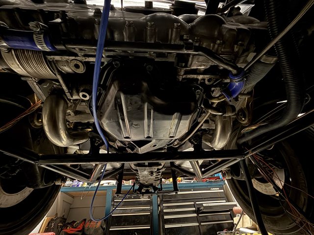

Exhaust going in. I am waiting on header stud bolts, so it’s resting on the cradle and sitting a bit low in this photo. Blue cable goes to shifter.
(IMG:http://www.914world.com/bbs2/uploads_offsite/i.imgur.com-26060-1756041620.1.jpg)

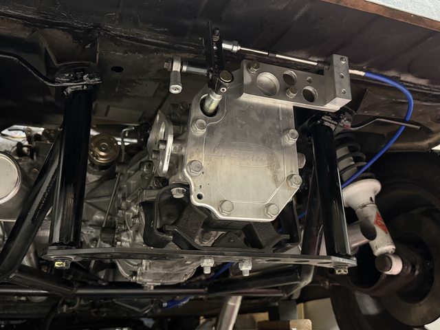

My shifter design. The off-the-shelf offering looked complicated for what it was trying to achieve and I just couldn’t bring myself to spend the money, so I made this out of scrap aluminum plate. It has fewer moving parts and employs readily-available boat control cables, which are cheaper than custom threaded cables. I made my own cable locks and the lever on the shaft is cut and welded from the original shift bracket + roll pin. It took a long time and multiple iterations to get it right. Still waiting on the 6ft fore-aft shift cable ($18 on Amazon!) but so far the side to side shift feels excellent.
(IMG:http://www.914world.com/bbs2/uploads_offsite/i.imgur.com-26060-1756041621.2.jpg)

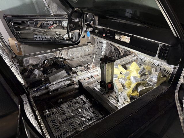

Added sound deadener. I want the car to be light(-ish), but also, I added this stuff inside the cab of a camper van that I rebuilt last fall and the effect on engine and road noise was amazing. Penalty here is 5-10 lbs and I’ll take it. Chassis stiffening kit is also in. Shifter turret is made from 3/8 hollow tube and is nice and light. The insulation in the passenger footwell is to go inside the centre console tunnel, which is next on the list (I think).
(IMG:http://www.914world.com/bbs2/uploads_offsite/i.imgur.com-26060-1756041621.3.jpg)

76-914   Nice James. I did basically the same shift set up ...   Aug 24 2025, 11:53 AM
jamlip   Hey Kent. The front is all 911 now. Steel crossme...   Aug 24 2025, 01:05 PM
