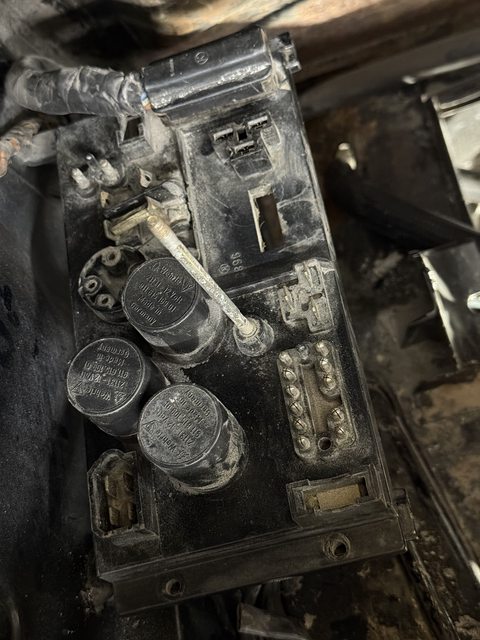

Been on the wiring today. I feel like a total idiot because I appear to have lost the part of the harness that attaches to the relay board and provides power to the stater solenoid, a feed to the oil pressure warning light, etc.
(IMG:http://www.914world.com/bbs2/uploads_offsite/i.imgur.com-26060-1756110050.1.jpeg)
Apart from that, it all kind of makes sense, although it has been so long since I took the car apart that I'm having some problems remembering what certain wires did.
Can anyone help me with these two conundrums?

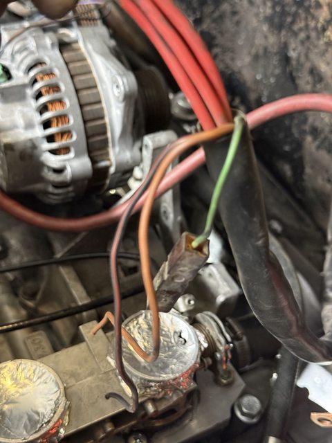

1. A red wire and a black / red wire, plus a third wire with a connector block on it. They're inside the sheath that carries four thick red feed wires to the battery. The red and black/red had a white circular-ish connector on it.
I believe the connect was for the fuel pump. It's fused at the relay board and would be be an excellent power source for my ECU, but I just cannot get 12v out of either of them. There's 12v at the bullet fuse on the relay board. Any ideas greatly appreciated.

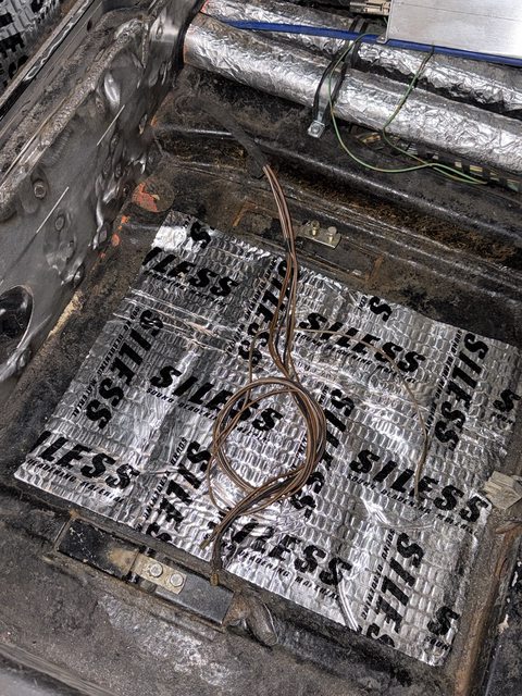

2. These wires exit the rear of the tunnel. I'm assuming they're seatbelt warning lights and / or engine bay heater blower controls. I can't work out where to look on the wiring diagram. Again, any help greatly appreciated!
(IMG:http://www.914world.com/bbs2/uploads_offsite/i.imgur.com-26060-1756110021.2.jpeg)

76-914   Toss the relay board James. It's just another ...   Aug 25 2025, 08:59 AM
jamlip   Looking at it in the cold light of day, you're...   Aug 25 2025, 01:40 PM
76-914   Looking at it in the cold light of day, you'r...   Aug 25 2025, 04:16 PM
