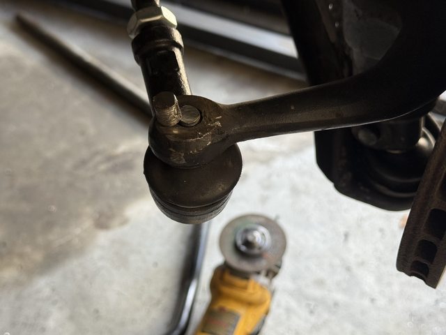

Started badly with this stripped nut on my stupid Uro tie rod end. I've had such bad luck with Uro stuff in the past, it was not a surprise. Must stop buying this garbage.
(IMG:http://www.914world.com/bbs2/uploads_offsite/i.imgur.com-26060-1756271994.1.jpeg)

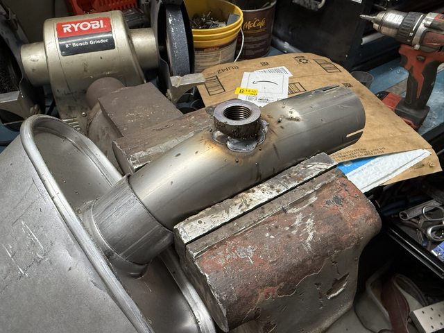

Stuck the O2 sensor bung in there whilst I was at it. For some reason I have accumulated a supply of seven of these over the years. I guess like projects.
(IMG:http://www.914world.com/bbs2/uploads_offsite/i.imgur.com-26060-1756271996.3.jpeg)

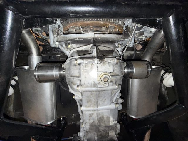

Subaru inner CVs are on.
(IMG:http://www.914world.com/bbs2/uploads_offsite/i.imgur.com-26060-1756271997.4.jpeg)
This is where I could use some help from someone who has been down this road before. This is the 944 CV and driveshaft in place on the hub, with the trailing arms at full droop on the shock absorbers. The axle obviously needs shortening. Anyone know how long? Or maybe the question is, where about does the tripod need to sit inside the cup?
The 922 shafts are 21.25 inches long, and I estimated removing 2.5 inches to make them 18.75 inches.
Based on forum search, I'll be using Dutchman for the work, unless anyone has other suggestions.

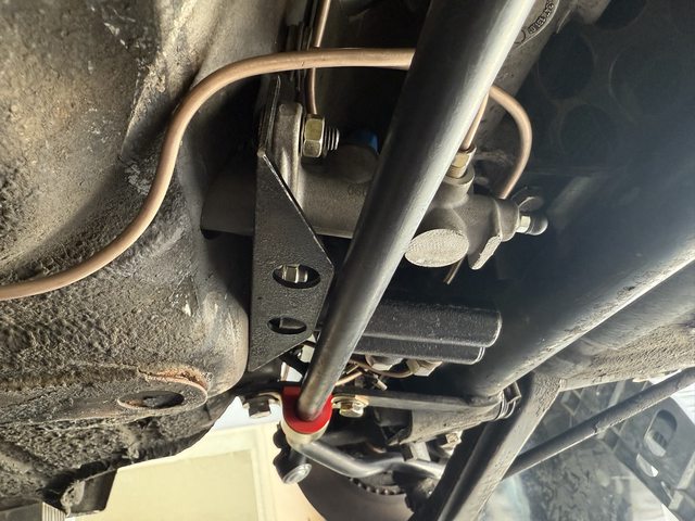

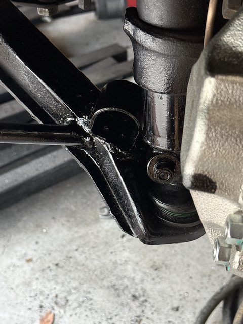

Next up was the front sway bar. Way back at the start of the project I decided a through-the-body bar was not going to work due to all the new plumbing below the gas tank, so I bought a 911SC-era under-body bar on eBay, plus some urethane mounts on Amazon.
I shouldn't have done this - the through-the-body bar is a better design for maintaining suspension geometry and travel, and it turned out I did have room for the bar where it crossed under the gas tank - my radiator plumbing is just below, out of the way.
It turns out what I actually didn't have room for was the under-body bay, due to my hydralic clutch master cylinder and the bracket I made for it. So I had to do some surgery on the master cylinder, cutting off part of the casting (that would probably be tapped for a port in another application) and also the bracket on the car.
(IMG:http://www.914world.com/bbs2/uploads_offsite/i.imgur.com-26060-1756271997.5.jpeg)

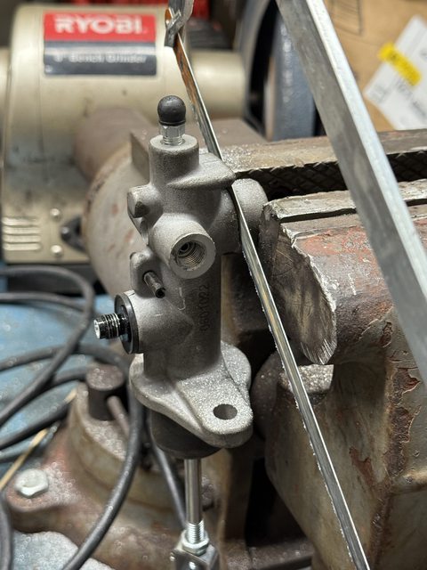

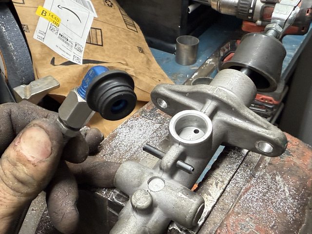

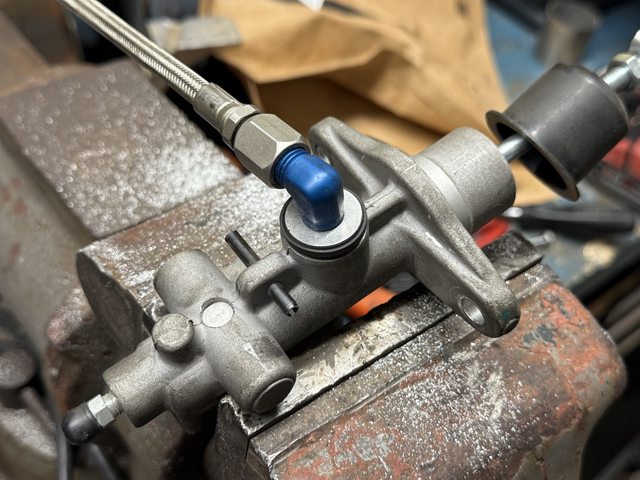

This also gave me a chance to rethink my remote reservoir fill situation. I used a lightly used airplane brake line, that I had in my box of stuff, with an AN elbow fitting pushed into the rubber plug.
(IMG:http://www.914world.com/bbs2/uploads_offsite/i.imgur.com-26060-1756271997.6.jpeg)
The 10mm thin stainless washer on top is to stop the end of the fitting bottoming out in the cylinder. Works nice. Once back in place, I cable tied the braided hose to a neighboring hard brake line to stop it coming out.
(IMG:http://www.914world.com/bbs2/uploads_offsite/i.imgur.com-26060-1756271998.7.jpeg)
The bar just clears it all.
(IMG:http://www.914world.com/bbs2/uploads_offsite/i.imgur.com-26060-1756272112.1.jpeg)
My A-arms had tabs for the through-the-body bar, so I cut those off and made some loops to accommodate the under-body style bushings. The bushings I had were polyurethane and would not squeeze in, so I've ordered some rubber ones. They were hard to find in 19mm.
(IMG:http://www.914world.com/bbs2/uploads_offsite/i.imgur.com-26060-1756271998.9.jpeg)
