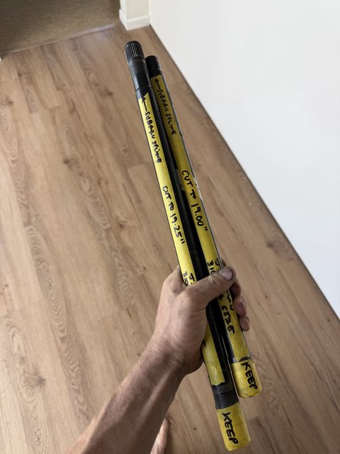

In case anyone is reading this on their own Subaru swap adventure, the way to measure the axles is as follows.
With the car in the air and the suspension at full droop on the shocks, seat the outer CVs in the stubs. Slide the Subaru CV cup onto the output splines of the gearbox. Eyeball how long you think the axle would have to be to sit inside the cup and -just- have enough clearance to slide onto the gearbox output stubs.
Cut the axles a little longer than you think, then try them. Keep doing this till the assembly will slide onto the stubs. Mark everything up and send off to be cut (I'm using Dutchman in Meridian ID).
My lengths were 19.00" driver side, and 19.25" passenger side.
(IMG:http://www.914world.com/bbs2/uploads_offsite/i.imgur.com-26060-1756333041.1.jpeg)
