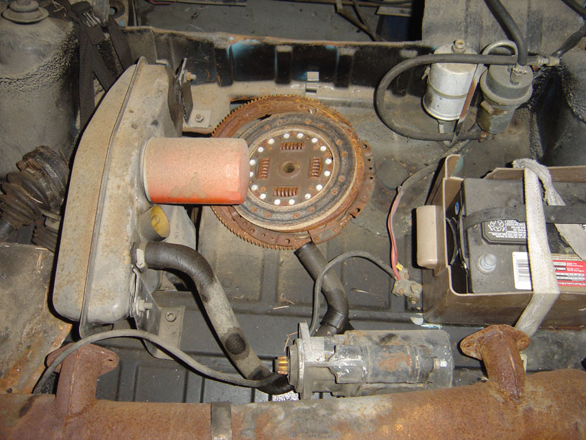

I am heading over to look at the slant nose 75 in Fountain Valley, its not really Fountain Valley, its Gargen Grove. I am going to look it over and see what all is there and take lots of pictures for you guys. I know you all love slant nose cars after all I have heard in the complaints about my car. But that is what makes us all individuals. I actually like the slant nose look but to each his own. Anyway, pics when I return. I will post them here since it seems to suck my bandwidth down so much if I post them on my server. It sucks browsing the interent when 20 people are downloading pictures and video.

Rear trunk filled with ? Is that a 6 tank? Or is that a 911 tank? Either way, its in the wrong place. Goes right through the floor of the trunk and hangs down below the car.

skline   Rear trunk filled with ? Is that a 6 tank? Or is t...   Feb 7 2005, 11:14 PM

skline   You can see the tank underneath. I also noticed re...   Feb 7 2005, 11:15 PM
