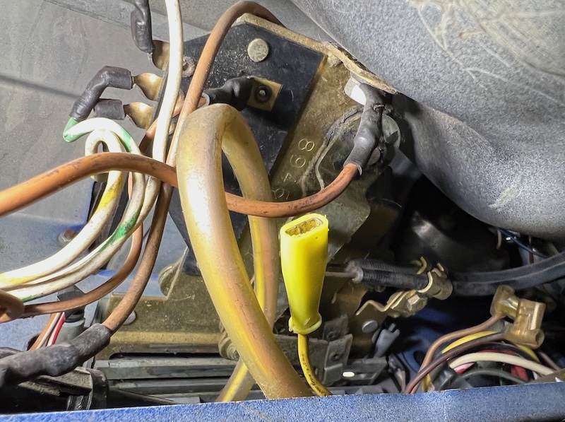

Are both sides of the blower control unit meant to illuminate?
I pulled ours out to clean and lubricate it. I could only find one wire with a bulb under the dash and it was plugged into the right side blue lens. Is that correct? There are two lenses, so I'd expect to find two bulbs.
If there is only one bulb, I'd expect it to go in the left red side. The car only has heat, no air. The owner's manual makes no mention of the lights. Just the sliders.

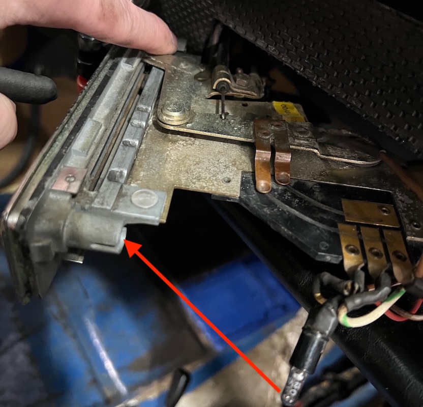

QUOTE(rjames @ Oct 24 2025, 04:41 PM) *
How do you get to the bulb? Does the whole unit pull out, or is access from underneath the dash?
I was able to get very good access to the bulb and blower controls without disconnecting any of the cables or wiring. I pulled the assembly forward through the dash. There is one nut on a stud from the firewall that needs to be remove. My finger is pointing to the bulb socket on the left side (red lens), where apparently nothing goes.
I think you could get the bulb in and out from behind if your hands aren't too big and you don't mind standing on your head under the dash.
