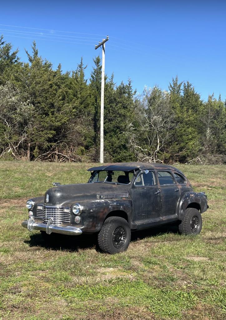

So here’s my next project now that the Safari 914 is done. I don’t anticipate getting into it until fall/winter, but I now have the base for the project. It’s a 1941 Cadillac series 61 that I plan to put on a modern Escalade platform.
If there’s interest I’ll update this as a project thread. I realize this is far from the intended scope of this forum, and if there’s no interest I’ll not fudge up the forum with this non-914 project. But if there’s interest, I’ll post progress once I dig in.

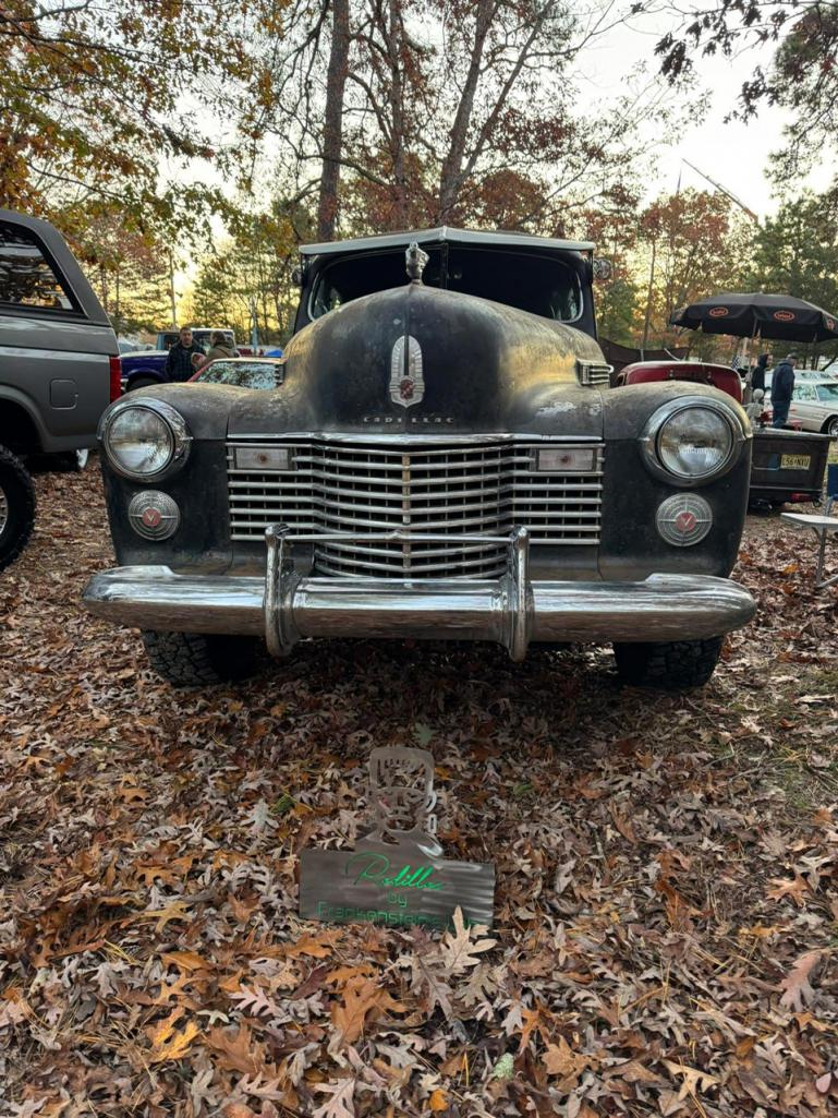

My project goal was to get this thing up and running enough to make my favorite car show of the year (The Pumpkin Run in EHT, NJ). Well, I made it and the show was great as always!
Now I just need to finish about 2 million more things to call the project done.
