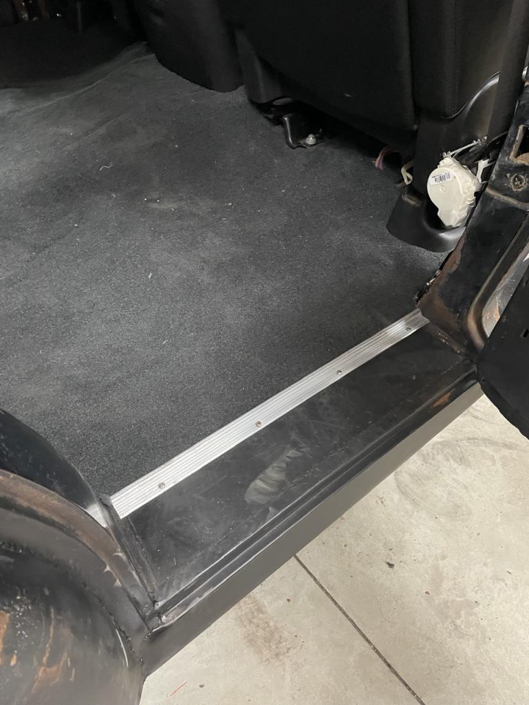

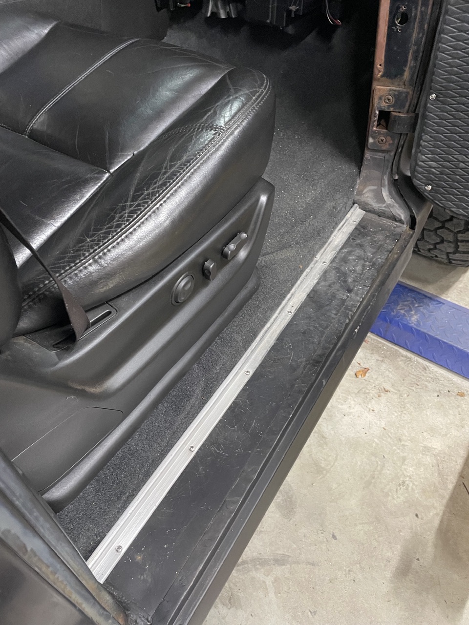

Another 914 part added to the mix. I needed trim for the carpet where it meets the door sills and I had some 914 threshold trims laying around. Believe it or not, the front door pieces fit perfect without modification. The rear doors needed a couple inches removed to fit.
