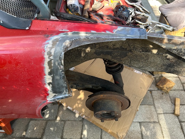

The drivers side rear quarter had a replacement fender very poorly lap welded on in a zigzag pattern sometime in its history.
Did I say poorly? Check out the welds. I’m a novice welder at best but I try to clean up my welds where I think it’s important. Here not so much. It was bondo’d right over.

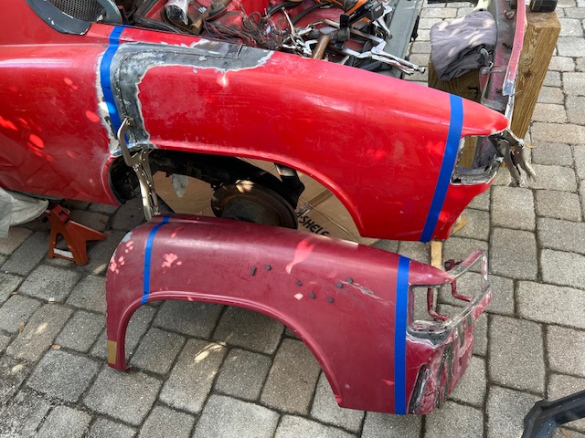

Rear tape line is reference for measurements. It is same on both fenders.
Forward tape line is the expected cut line on each fender allowing for about an inch of overlap for fitting and trimming to butt weld.
I’ve marked a straight cut up the fender unlike what was done before.
Is this an okay idea?
I have not done this before but I can see it was done differently in the past.

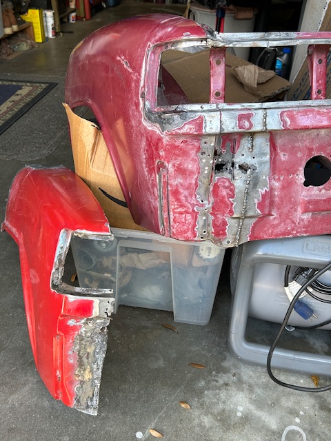

My current thinking is to keep the whole corner of the replacement together and have vertical welds in the fender and the tail panel rather than separate the replacement into its piece parts as I started to do. Note the replacement piece came cut up and I’ve started splicing it back together. To do what I’m thinking I’ll have to remove all the inner structure from the replacement leaving only the fender and the tail panel.
The replacement piece does need work.
Let me know your thoughts on this.
Thank you,
Sean
