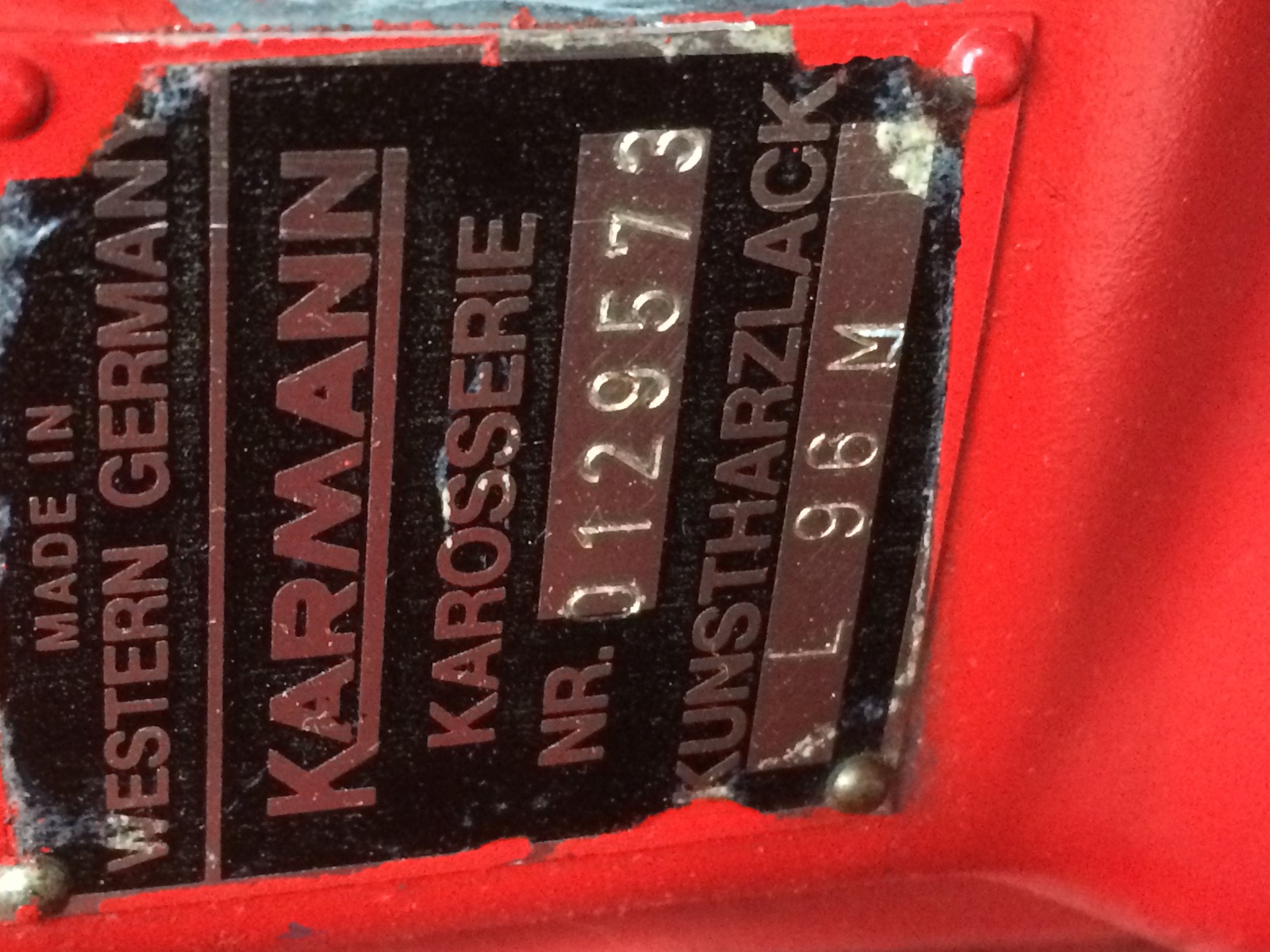

Whats the code for the original color on this car? My monitor makes it look like a light green metallic aka special order...

L96M
Original is a light blue metallic. Currently painted a reddish orange.

QUOTE(seanpaulmc @ Feb 1 2017, 04:35 PM) *
L96M
Marathon Blue, I need to adjust my monitor (IMG:style_emoticons/default/laugh.gif)
