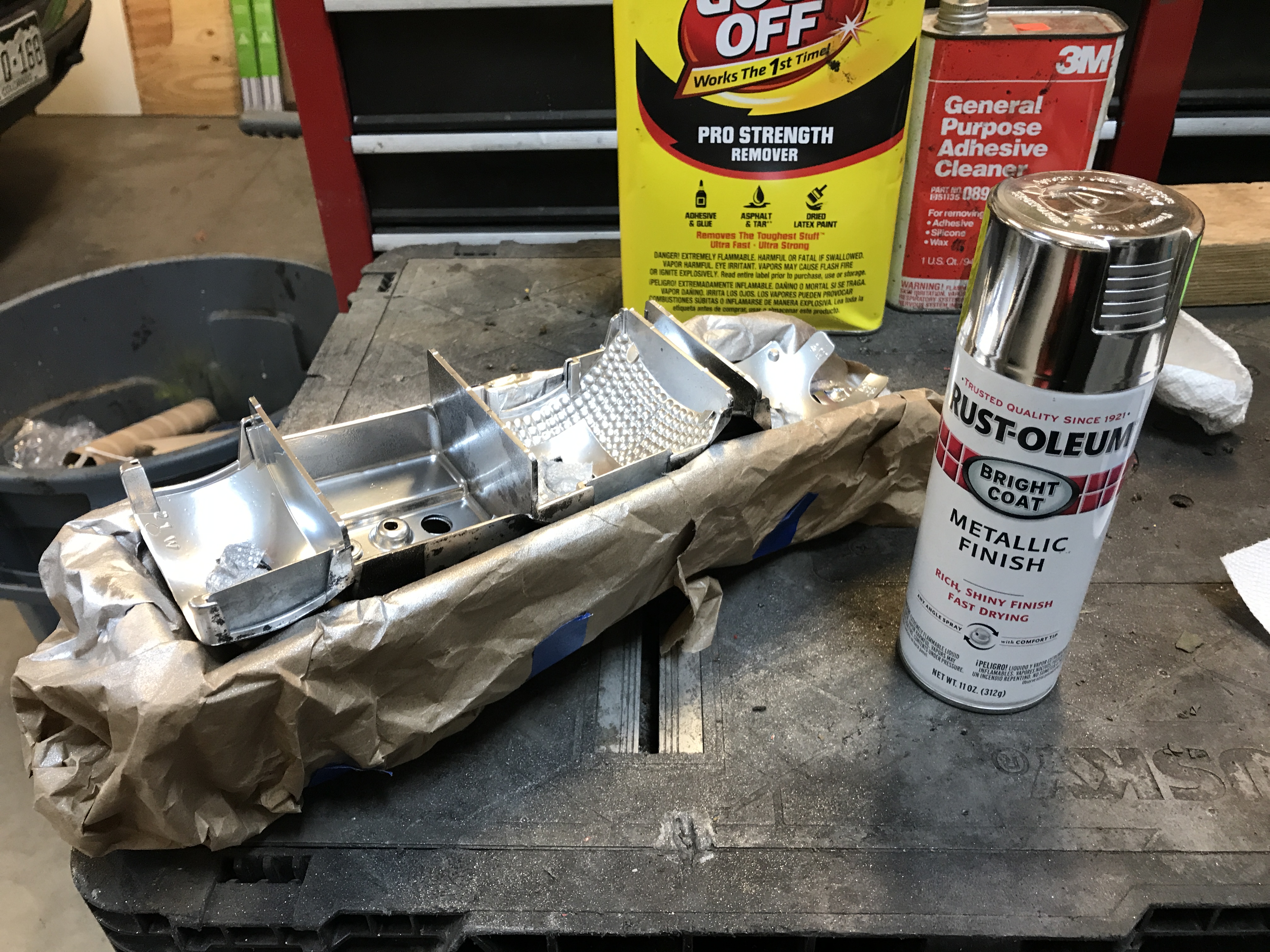

I'm in the process of restoring my tail lights. The reflective coating inside the housings is faded out pretty good so what is a good way to recoat ? maybe spray paint or reflective tape? Thanks

Another vote for "chrome" spray paint. Not quite a mirror finish but very reflective, and enough to bounce light out through the red lens.

Geezer914 I used chrome paint with good results. Dec 29 2025, 04:47 PM

Rob-O I used silver spray paint with excellent results. ... Dec 29 2025, 08:08 PM
