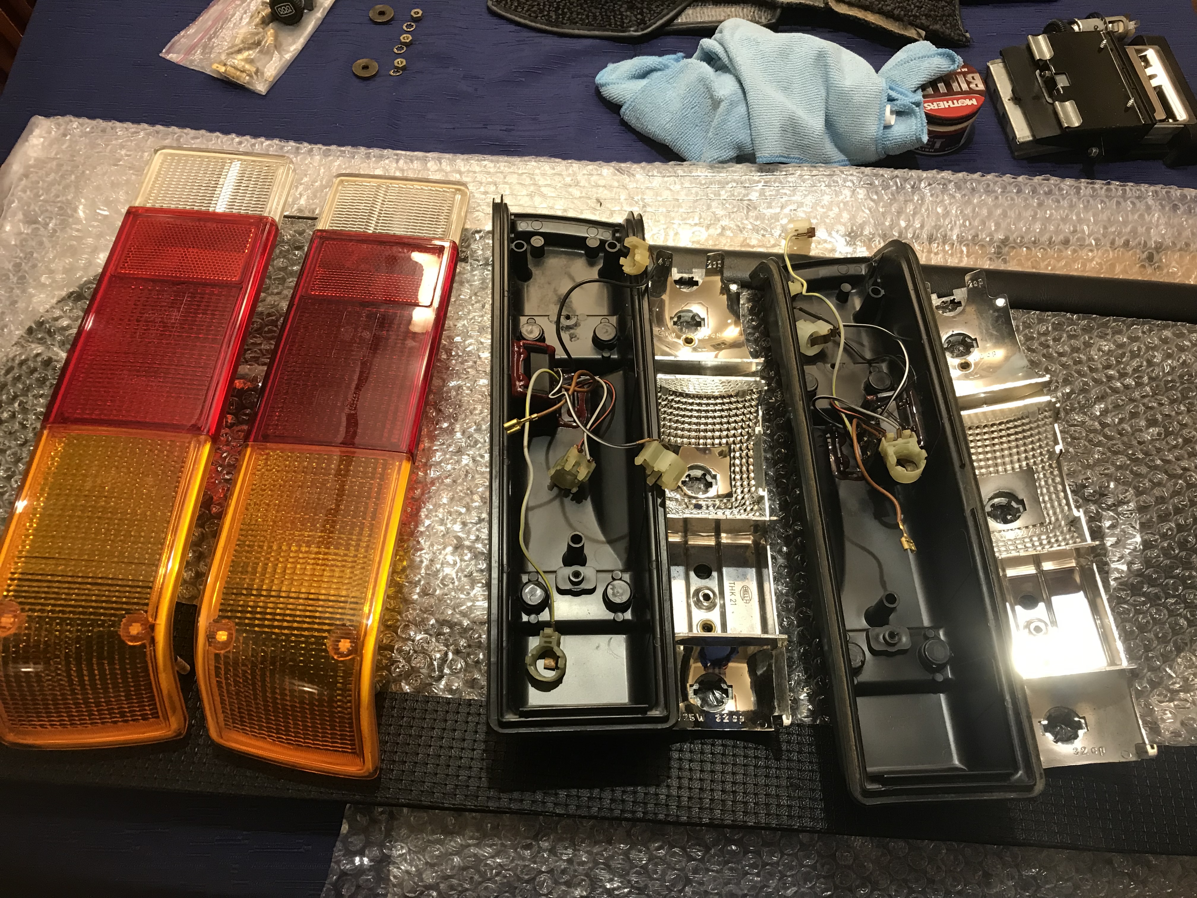

We restored several sets by sending to https://www.gcartrim.com/
It was about $45 per housing, but came back looking stock. This was 2016 pricing… but about to send another batch. Attached thumbnail(s) |
