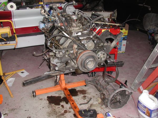

I figure I will start the build thread. I have the 18 X18 X1 inch plate for the adapter I need to get this sent up to Rick so He can grind it into shape while I get the engine running consistantly (IMG:style_emoticons/default/mueba.gif) I have already sold off some of the 928 parts to fund this thing. I will update this thread as we go along this pathway to fun. (IMG:style_emoticons/default/wacko.gif)

r_towle   Could you please explain the need for modifying th...   Jan 17 2005, 10:32 PM
rick 918-S   The oil pan on the 928 motor sticks out the front ...   Jan 17 2005, 11:00 PM
r_towle   Rich, you are certainly a guy with balls. I want ...   Jan 17 2005, 11:05 PM
rick 918-S   r_towle response: Larry, Post that picture of t...   Jan 17 2005, 11:36 PM
r_towle   looking at that motor on the stand...and given tha...   Jan 17 2005, 11:43 PM
rick 918-S   Search through this thread about my car. There sho...   Jan 17 2005, 11:51 PM
ClayPerrine   I have been over to see the motor for this project...   Jan 18 2005, 04:03 AM
rick 918-S   yes, I think the motor can move back if you sacrif...   Jan 18 2005, 06:22 AM
