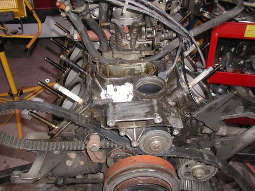

spare time toys   Well I got the head off on the left side today bef...   Jan 20 2005, 06:28 PM
spare time toys   Now the uglyness I broke an allen wrench off in on...   Jan 20 2005, 06:32 PM

spare time toys   I got the right head off and test fit Ricks mount ...   Feb 11 2005, 05:45 PM
spare time toys   Its going to take a bunch of elbow grease to get r...   Feb 11 2005, 05:48 PM

spare time toys   Ive been cleaning crud off the block   Feb 20 2005, 05:48 PM
spare time toys   It was about two inches deep in here   Feb 20 2005, 05:50 PM

ws91420   Is the void around the cylinders the waterjacket? ...   Feb 20 2005, 08:09 PM
jim912928   it's going to be pretty....looking good and ke...   Feb 20 2005, 08:16 PM
spare time toys   <...   Feb 20 2005, 09:59 PM
