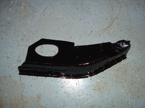

The repair piece from a parts car.

cdmcse   The repair piece from a parts car.   Feb 13 2005, 12:18 AM
