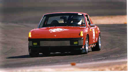

I raced the car attached for three years with 15x7's and 15x8's. I ran 225's all the way around. I do not think you should run larger than 255's on an 8 inch rim.
