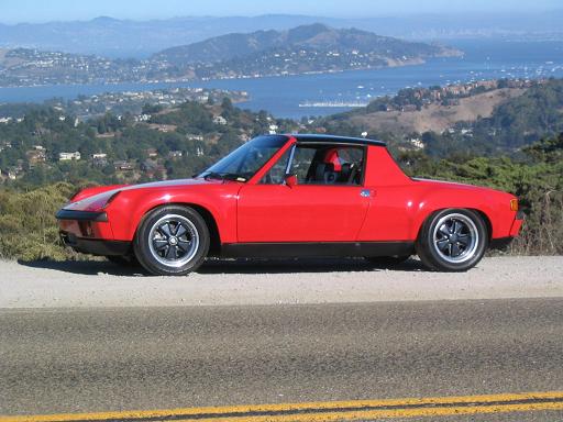

I ADDED A PHOTO OF MY "NEW" CAR. SCROLL DOWN ABOUT 15 POSTS...

post Feb 18 2005, 08:16 PM
Whole lot 'O 914/6
Posts: 157
Joined: 15-November 04
From: Mount Pleasant, SC
Member No.: 3,122
Here is a photo of my car.
Thanks for all the help.

ken914   Here is a photo of my car. Thanks for all the he...   Feb 18 2005, 08:16 PM
