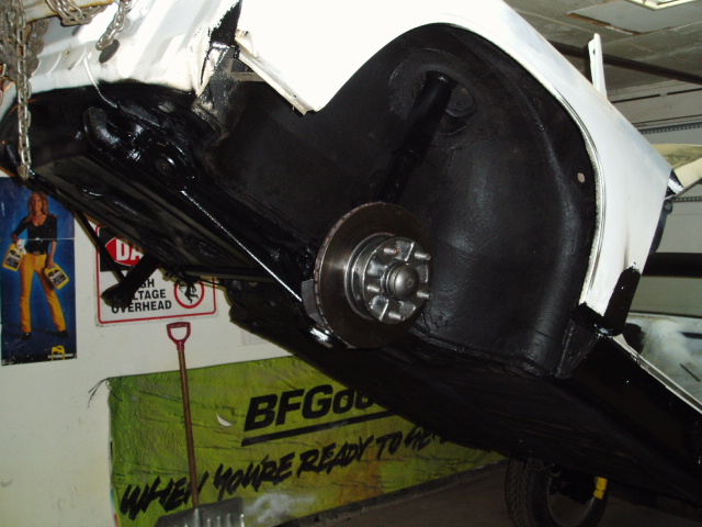

welded, sealed, undercoated and starting to install stuff, once again. I am having trouble w/the calipers fitting correctly though.

xsboost90   got my turbo tie rods, installed the rack again af...   Feb 13 2005, 10:39 AM
xsboost90   she is puuurrdy under der.   Feb 19 2005, 06:48 PM
CptTripps   Did you scrape everything out of the wheel wells b...   Feb 19 2005, 09:28 PM
xsboost90   i tried a bunch, best out there is 3m, the big can...   Feb 19 2005, 10:38 PM
CptTripps   I've got a can of the NAPA stuff, the DynaMat ...   Feb 20 2005, 09:32 AM
xsboost90   i wire brushed the old stuff off and roughed up th...   Feb 20 2005, 09:36 AM
CptTripps   Looking back at your older posts... Are the holes...   Feb 20 2005, 10:01 AM
Aaron Cox   throw A sway abr on there while you are doing fron...   Feb 20 2005, 12:39 PM
xsboost90   oh yes, a sway will be in there before the tank go...   Feb 20 2005, 02:20 PM
xsboost90   well, it took some small spacing but the calipers ...   Feb 22 2005, 09:46 PM
CptTripps   ::: golf claps ::: Nice work...that's about w...   Feb 22 2005, 10:16 PM
Dave-O   Isn't it a great feeling to get her back on he...   Feb 22 2005, 11:17 PM
