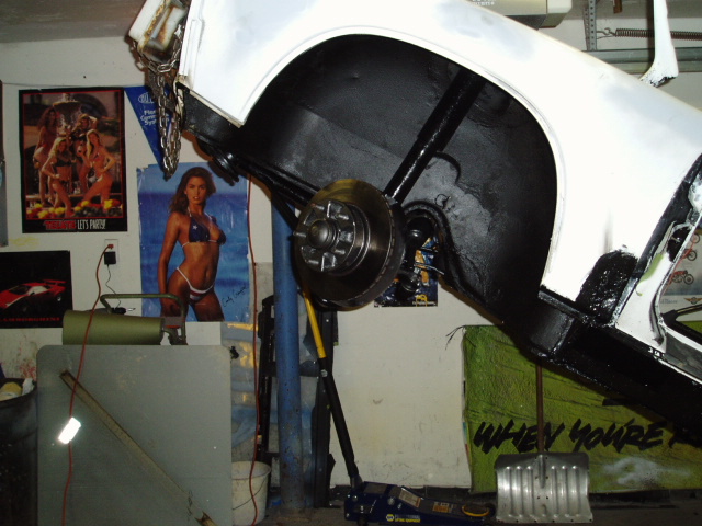

xsboost90   welded, sealed, undercoated and starting to instal...   Feb 19 2005, 06:46 PM
xsboost90   she is puuurrdy under der.   Feb 19 2005, 06:48 PM
