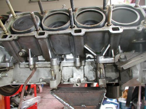

spare time toys   Ive been cleaning crud off the block   Feb 20 2005, 05:48 PM
spare time toys   It was about two inches deep in here   Feb 20 2005, 05:50 PM
Maltese Falcon   If you need any of your steel engine parts metalli...   Feb 20 2005, 06:26 PM
rick 918-S   I was chatting with a guy in Texas that built a su...   Feb 20 2005, 06:36 PM
ws91420   Is the void around the cylinders the waterjacket? ...   Feb 20 2005, 08:09 PM
jim912928   it's going to be pretty....looking good and ke...   Feb 20 2005, 08:16 PM
spare time toys   <...   Feb 20 2005, 09:59 PM
