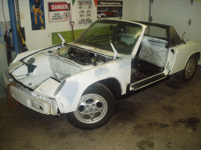

ill go ahead and introduce myself as im a regular on rennlist and recently more on here. My name is dan(xsboost90) since i used to be big time into turbo mk3 supras. Got my first porsche a year ago-89 944 and after doing alot of work/paint etc..traded it for a 924s and a 76 914 2.0. Now im in the process of rebuilding from the ground up this car including cutting out some rust-not too bad someone had already done alot-PO owned a body shop- but missed some in the floor and fenders. I also purchased a motor which has already been totally rebuilt w/ very little milage and a cam from someone local who needed more-200hp 2.0 rat motor!!- for their project. Ill go ahead and start a thread and try to keep its progress posted for those who find these things handy. I also have a couple of pics of what i plan on it to look like in the next couple months when i paint it..yes im a jack of all trades so to speak. Thanks, stay tuned. (IMG:style_emoticons/default/driving.gif)

well, it took some small spacing but the calipers fit like a glove. Finally got the rack hooked back up and the parts prepped, painted and installed. Yet to get brake lines or mc yet. Now its time to prep under the tank area, get ready for a sway bar, and do some body work! Also got my euro german plate in to stick up front. Progress..i can see it coming together finally!
