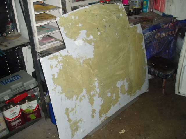

xsboost90   got the quarter stipped and sanded completely, sti...   Feb 26 2005, 07:43 PM
xsboost90   drivers quarter is perfect but the ps has some dam...   Feb 26 2005, 07:46 PM
