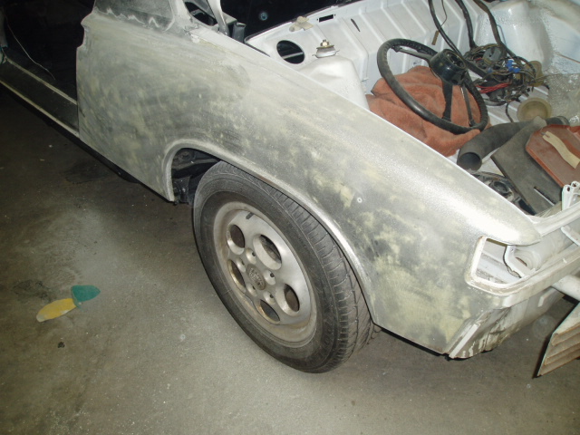

got the quarter stipped and sanded completely, still working on the door jam though, it was brazed in a couple spots and the filler above that cracked, so now im trying to weld, grind, fill it so it wont come back.

xsboost90   time to get her all stripped for some primer/ pain...   Feb 26 2005, 07:41 PM
xsboost90   drivers quarter is perfect but the ps has some dam...   Feb 26 2005, 07:46 PM
