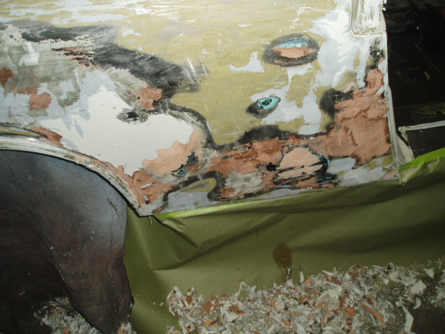

drivers quarter is perfect but the ps has some damage, not too bad, just need to grind it all out and redo it just to make sure.
