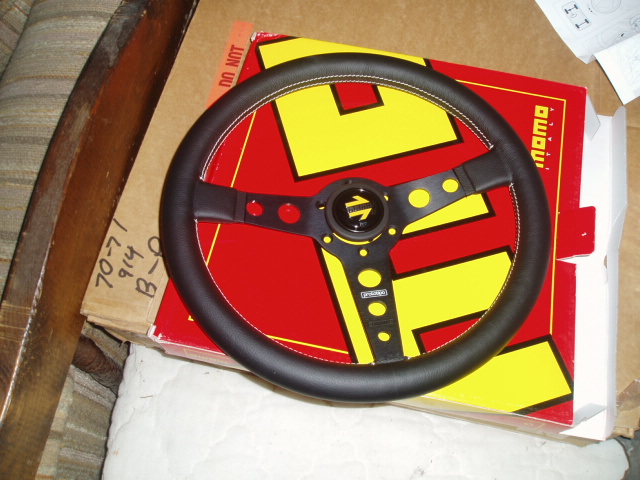

oh, and another toy i got today, actually its a belated birthday present, just came in... (IMG:http://www.914world.com/bbs2/html/emoticons/rolleyes.gif)
