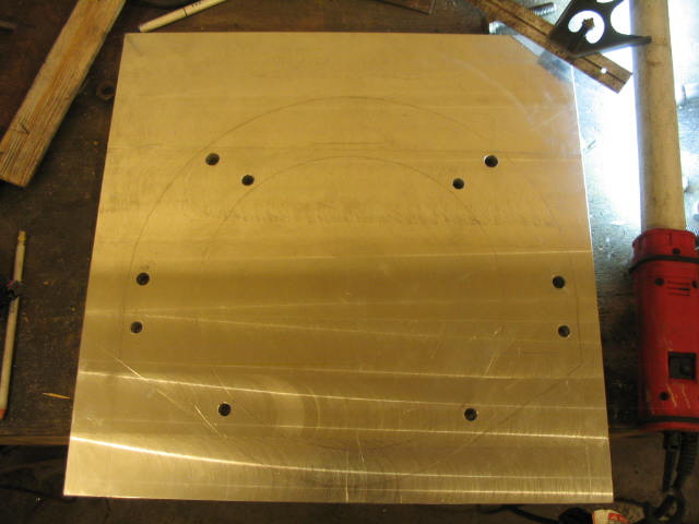

I figure I will start the build thread. I have the 18 X18 X1 inch plate for the adapter I need to get this sent up to Rick so He can grind it into shape while I get the engine running consistantly (IMG:style_emoticons/default/mueba.gif) I have already sold off some of the 928 parts to fund this thing. I will update this thread as we go along this pathway to fun. (IMG:style_emoticons/default/wacko.gif)

Mueller   that is a big chunk of aluminum....cost if I may a...   Dec 3 2004, 08:58 PM
