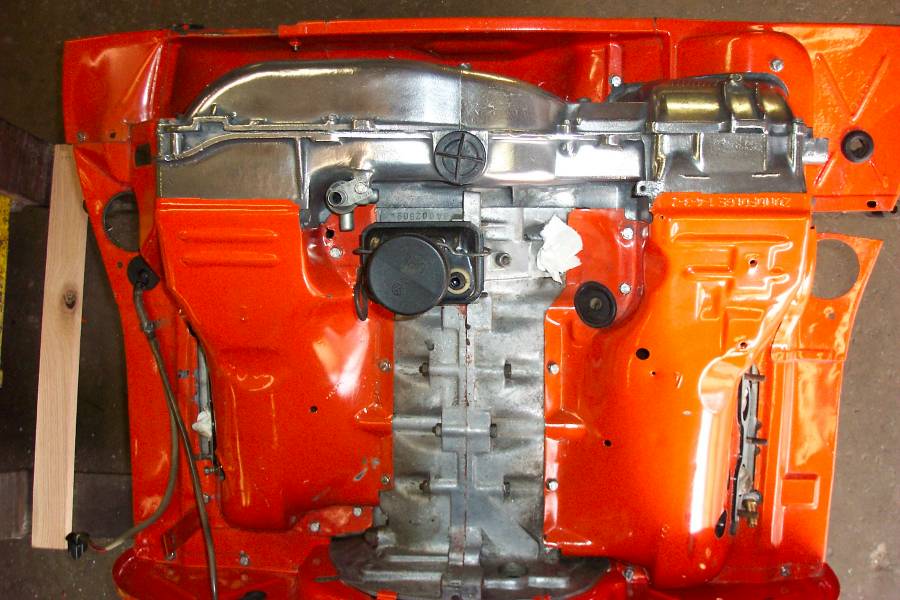

Speaking of cleaning engine tin, hers's a pic of our spare motor ready to go in my car will I do a 2056 build. I did a little clean up. (IMG:http://www.914world.com/bbs2/html/emoticons/biggrin.gif) Attached thumbnail(s)

Headrage Where is your rod for the cooling flaps? Feb 27 2005, 06:06 PM
vsg914 Cooling flaps were long gone from this motor, alon... Feb 27 2005, 06:12 PM
