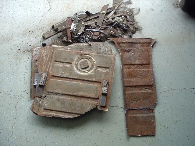

Ok I made some more progress this weekend. I got the old floorpan out, here are the removed bits...
