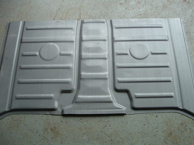

post Feb 27 2005, 11:37 PM
Posts: 340
Joined: 17-December 04
From: Georgetown, Ky
Member No.: 3,305
The new pan...

cdmcse   Ok I made some more progress this weekend. I got t...   Feb 27 2005, 11:36 PM
cdmcse   The new pan...   Feb 27 2005, 11:37 PM
