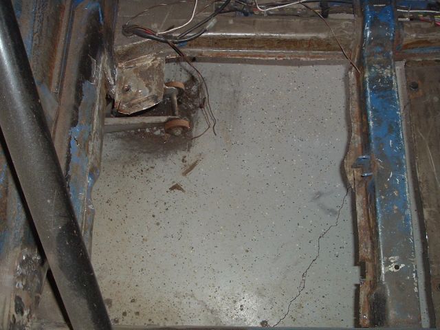

It seemed like it was going to take forever to make some progress on my rust repair. After spending the entire winter locating parts, grinding, cuting, painting, and learning to weld, I was finally ready to take the plunge....
Also thanks to everyone on the board, I would have never had enough confidence to tackle this without this site!!!
BTW: I must be getting addicted to the "914 lifestyle" as I had withdrawal when the site was down. (IMG:http://www.914world.com/bbs2/html/emoticons/happy11.gif)
Fist Pic : The Rust
