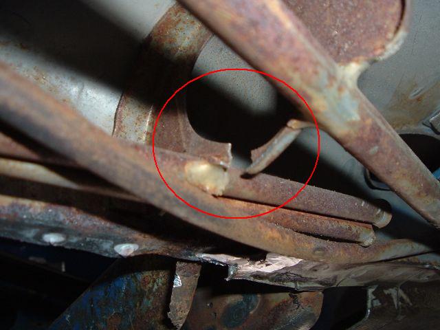

Broken clutch tube support about half way down the tunnel...

cdmcse   Broken clutch tube support about half way down the...   Feb 27 2005, 11:48 PM

cdmcse   I welded all the clutch tube breakage, then I adde...   Mar 2 2005, 01:54 AM
