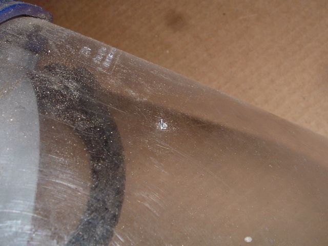

Why you should always wear your safety gear. This is the safety face shield I wear, and that is a small sliver of metal stuck in it. Am I posting too many pics?

Travis Neff   Never too many pics, NEVER!   Mar 1 2005, 10:45 AM
