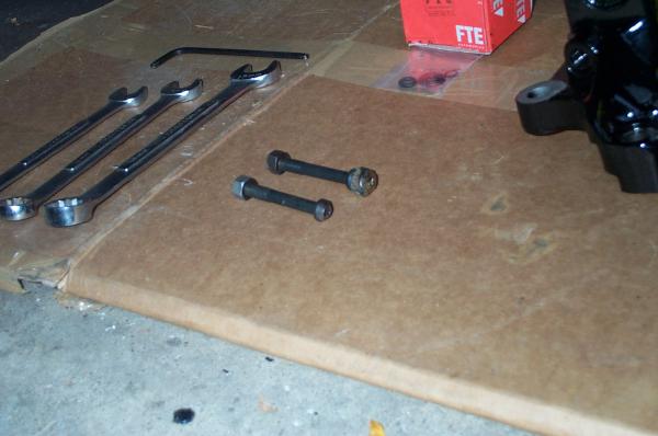

(IMG:style_emoticons/default/headbang.gif) It seems like my caliper bolts will not budge!! Does anyone have any tips or tricks that might help me out?

Are these the through bolts?
If so, you're going to strip the torx type ends (or just break your tools off.) Sacrifice the bolt. Spot weld a nut on the end of the bolt, and and then you can grab it with a ratchet from each end.
