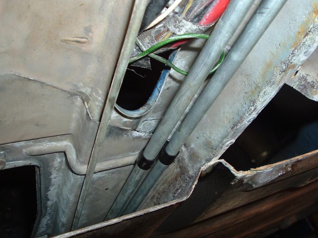

New metal fuel lines secured to the center of the tunnel.
