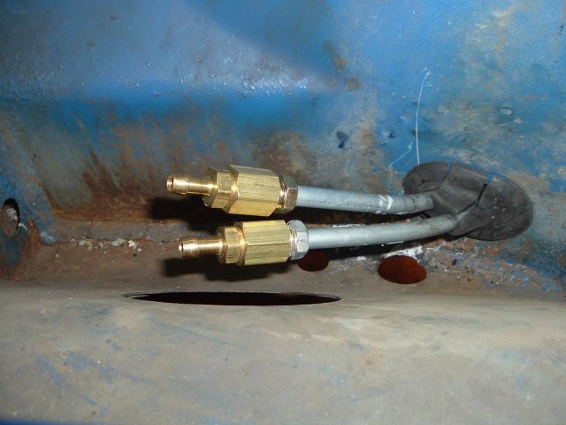

cdmcse   Broken clutch tube support about half way down the...   Feb 27 2005, 11:48 PM
cdmcse   Broken tube at the firewall...   Feb 27 2005, 11:49 PM
cdmcse   Look, I made some cash while tearing out the floor...   Feb 27 2005, 11:51 PM
cdmcse   Forgot the pic.   Feb 27 2005, 11:52 PM

cdmcse   I welded all the clutch tube breakage, then I adde...   Mar 2 2005, 01:54 AM
cdmcse   New metal fuel lines secured to the center of the ...   Mar 2 2005, 01:55 AM
cdmcse   Fuel Tank end   Mar 2 2005, 01:56 AM
cdmcse   Firewall End.   Mar 2 2005, 01:56 AM
cdmcse   POR-15 Applied. Is there anything else I should d...   Mar 2 2005, 01:58 AM
