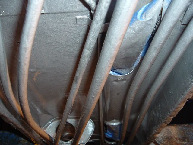

cdmcse   Ok I made some more progress this weekend. I got t...   Feb 27 2005, 11:36 PM

cdmcse   Who wants to see down my tunnel?   Feb 27 2005, 11:40 PM

cdmcse   I welded all the clutch tube breakage, then I adde...   Mar 2 2005, 01:54 AM
cdmcse   New metal fuel lines secured to the center of the ...   Mar 2 2005, 01:55 AM
cdmcse   Fuel Tank end   Mar 2 2005, 01:56 AM
cdmcse   Firewall End.   Mar 2 2005, 01:56 AM

cdmcse   OK, more progress...Top coated the POR-15 with som...   Mar 4 2005, 01:22 AM
cdmcse   http://www.914world.com/bbs2/...   Mar 4 2005, 01:23 AM
cdmcse   Driver's Side.   Mar 4 2005, 01:24 AM
cdmcse   Passenger Side. Next I have to finish the passenge...   Mar 4 2005, 01:26 AM
