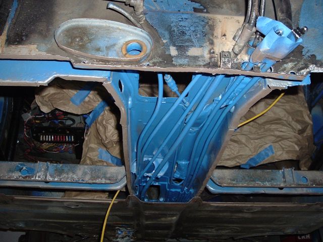

OK, more progress...Top coated the POR-15 with some rattle can blue.

cdmcse   POR-15 Applied. Is there anything else I should d...   Mar 2 2005, 01:58 AM

cdmcse   http://www.914world.com/bbs2/...   Mar 4 2005, 01:23 AM
cdmcse   Driver's Side.   Mar 4 2005, 01:24 AM
cdmcse   Passenger Side. Next I have to finish the passenge...   Mar 4 2005, 01:26 AM
Jeroen   Impressive job! Go have a   Mar 15 2005, 01:19 AM
SpecialK   Now that's a view of the center tunnel you don...   Mar 15 2005, 03:07 AM
Lou W   Looks great http://www.914wo...   Mar 15 2005, 11:41 AM
Travis Neff   That's love buddy, painting to match on the in...   Mar 15 2005, 11:49 AM
Gint   Good lookin work!   Mar 15 2005, 01:02 PM
