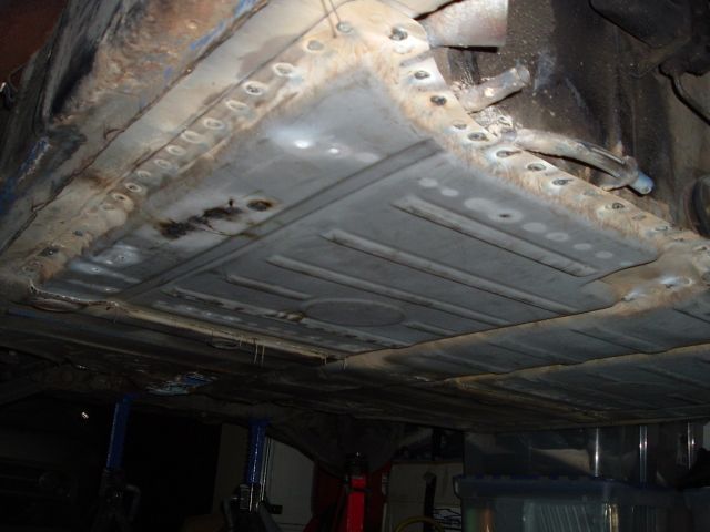

It seemed like it was going to take forever to make some progress on my rust repair. After spending the entire winter locating parts, grinding, cuting, painting, and learning to weld, I was finally ready to take the plunge....
Also thanks to everyone on the board, I would have never had enough confidence to tackle this without this site!!!

(IMG:http://www.914world.com/bbs2/html/emoticons/smilie_pokal.gif) Yay, the floorpan is in!

Lou W   Looks great, keep the pictures coming. I'm get...   Feb 13 2005, 01:30 AM
Bleyseng   Whats with the electrical cable coming out of the ...   Feb 13 2005, 09:41 AM
jd74914   looks good http://www.914worl...   Feb 13 2005, 10:10 AM
cdmcse   These cables in the heater tubes are for a front t...   Feb 13 2005, 11:25 AM

SirAndy   did you spray plenty of "metal-ready" inside that ...   Feb 23 2005, 11:57 PM
cdmcse   Yep, I metal readied the hell out of it it. Then I...   Feb 24 2005, 12:09 AM

cdmcse   Ok I made some more progress this weekend. I got t...   Feb 27 2005, 11:36 PM
cdmcse   The new pan...   Feb 27 2005, 11:37 PM
cdmcse   Zee Hole...   Feb 27 2005, 11:39 PM
