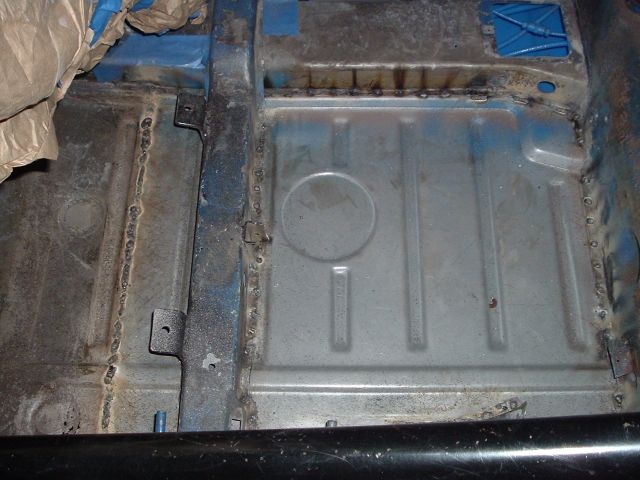

cdmcse   Ok I made some more progress this weekend. I got t...   Feb 27 2005, 11:36 PM
cdmcse   The new pan...   Feb 27 2005, 11:37 PM
cdmcse   Zee Hole...   Feb 27 2005, 11:39 PM

cdmcse   Well, after the arrival of our new son (March 6th)...   Apr 4 2005, 10:52 PM
cdmcse   Now back on topic...Passenger side floor re-enforc...   Apr 4 2005, 10:54 PM
cdmcse   Driver's side floor re-enforcement, this one i...   Apr 4 2005, 10:56 PM

cdmcse   Well I reached what I feel like is a major milesto...   Apr 12 2005, 09:44 PM
cdmcse   Another...   Apr 12 2005, 09:45 PM
cdmcse   Another   Apr 12 2005, 09:46 PM
cdmcse   Last one. Now just a few more bits on the outside ...   Apr 12 2005, 09:47 PM
dakotaewing   How did you apply the Por-15 and primer? Gun or br...   Apr 12 2005, 09:52 PM
