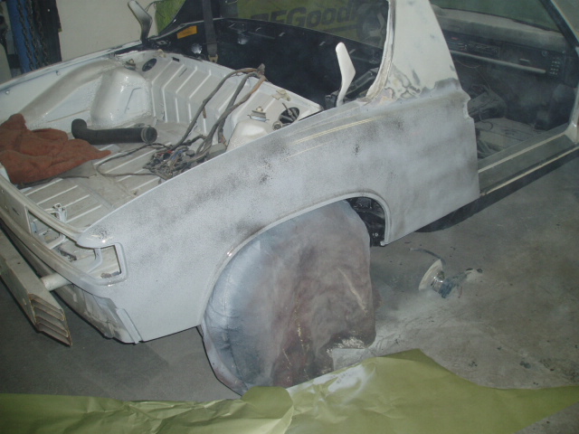

sprayed alittle primer tonite, its just for blocking out body work, but its progress. Ds quarter looks good, two little dingers. Ps is getting close.Hopefully she'll be ready for paint before next month.

xsboost90   time to get her all stripped for some primer/ pain...   Feb 26 2005, 07:41 PM
xsboost90   got the quarter stipped and sanded completely, sti...   Feb 26 2005, 07:43 PM
xsboost90   drivers quarter is perfect but the ps has some dam...   Feb 26 2005, 07:46 PM

xsboost90   more primer.   Mar 4 2005, 09:56 PM

xsboost90   mine would be mostly in primer by now but this qua...   Mar 31 2005, 09:58 PM
kafermeister   Dan, I've got a right rear quarter I'd sel...   Apr 1 2005, 09:28 AM
xsboost90   naw, i think i got the quarter whipped, got most o...   Apr 3 2005, 09:50 PM
